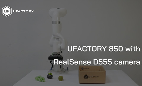

  • UFACTORY 850(Gigabit Ethernet cable) + Realsense D555 + UFACTORY Gripper G2
    Watch the video

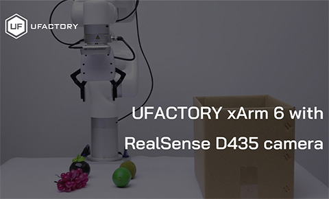

  • xArm6 + Realsense D435 + UFACTORY Gripper G1
    Watch the video

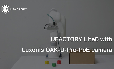

  • Lite6 + Luxonis OAK-D-Pro-PoE + Vacuum Gripper Lite
    Watch the video
