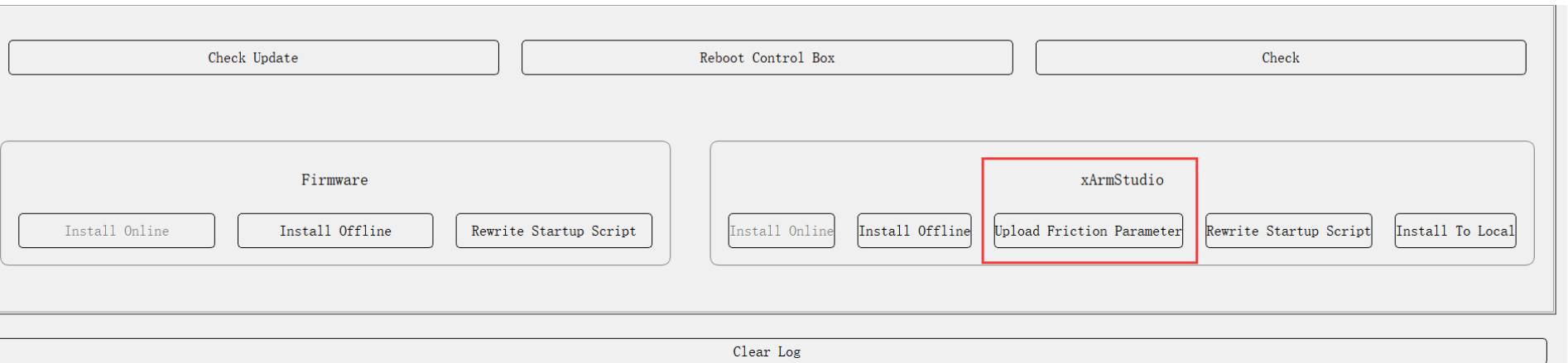

Method for Loading Friction Files Using GUI Tool for xArm 5/6/7 (Versions Before XX1300)
Contact UFACTORY technical support, send them the robot arm SN, and they will send you the friction files. Download and run the GUI tool, download link: https://drive.google.com/drive/folders/1WOcMMRXo0XACg48d3BR2Ki-kUKioCyGm?usp=drive_link Click the load friction file button to load the friction file. Reboot the control box to take effect.
