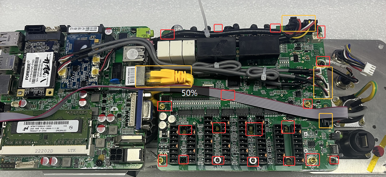

  2. Remove 19 screws, and unplug 8 cables. Please mark the wire sequence properly. If the cable is plugged incorrectly, the IO board may be burned out.

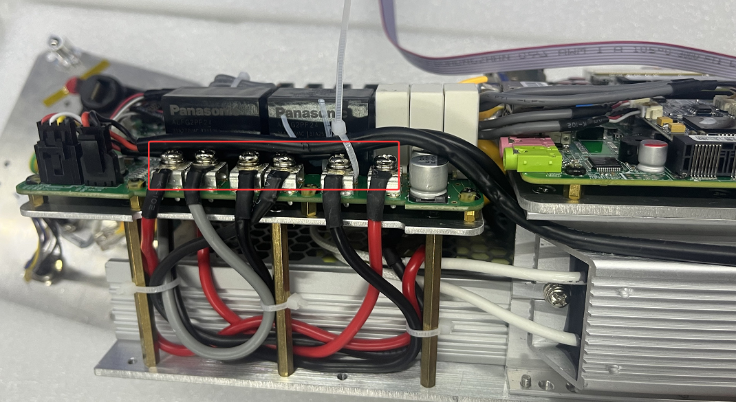

  3. Remove 6 cables.

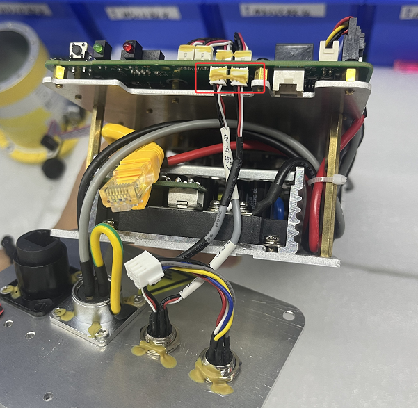

  4. Remove 2 cables.
