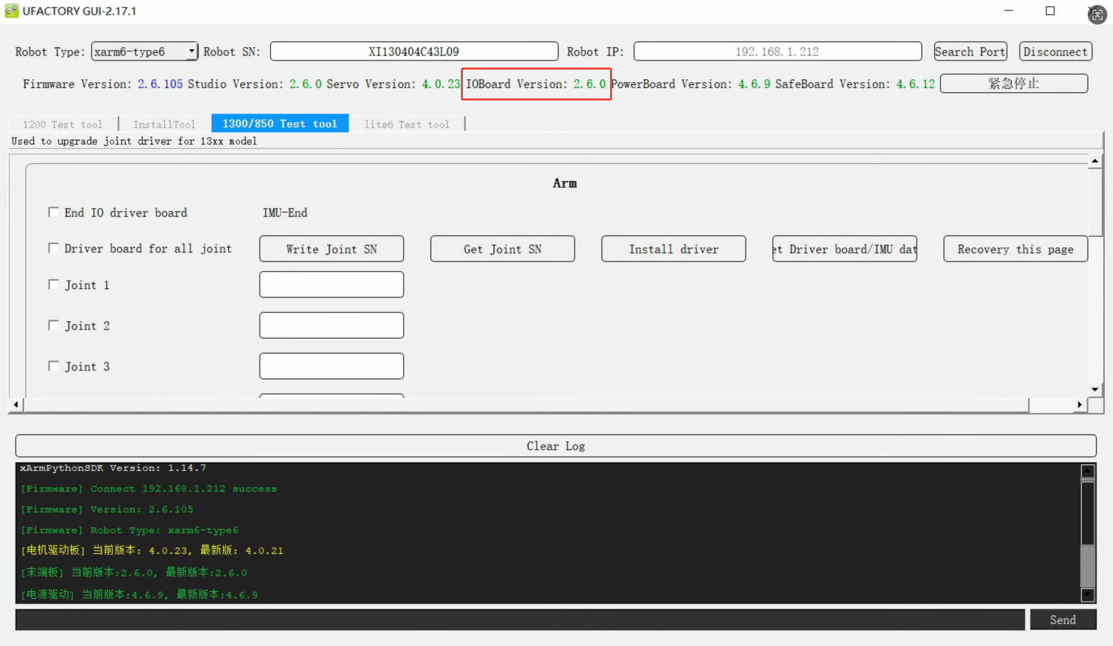

How to check the end IO board version?
Launch xarm-tool-gui, enter the Robot IP and click Connect. As shown in the figure below, the IO Board version is V2.6.0.

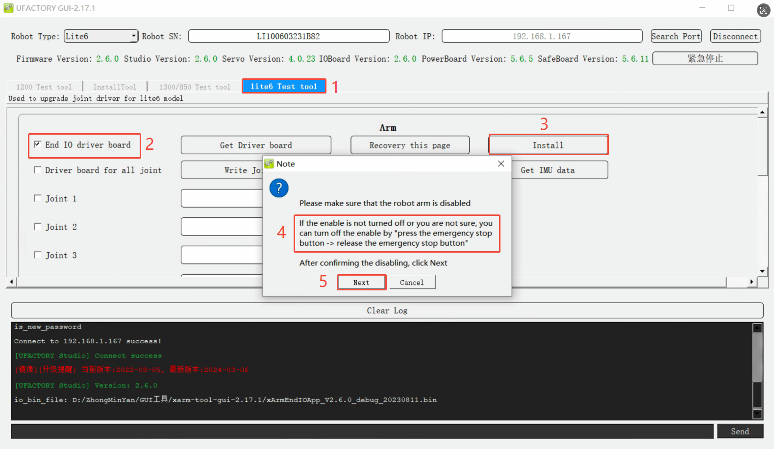

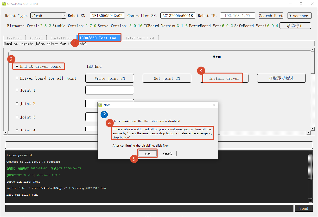

How to update the end IO firmware?
- Connect with xarm-tool-gui.
- Switch to the corresponding test tool, choose End IO driver board,click install driver, choose the corresponding bin file. Press down the Emergency stop button and release, click Next.
- 1305 or 850: 1300/850 Test tool
- Lite6: Lite6 Test tool
- xArm12xx or lower version: 1200 Test tool
- Wait for 1-2 minutes, it will prompt 'Installation Success'. The arm will reboot automatically. Wait for 1-2 minutes, re-connect with xarm-tool-gui, enable the robot, and check the end io board version.
