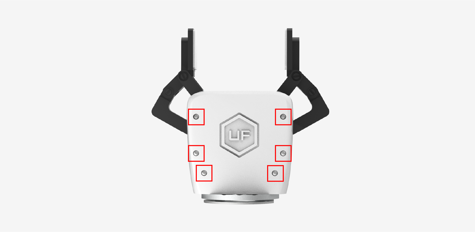

  1. Press down the E stop button.
  2. Remove 6 screws on the gripper cover and manually turn the motor of the gripper, to close the gripper.
  3. Release the E stop button and Enable the robot.
