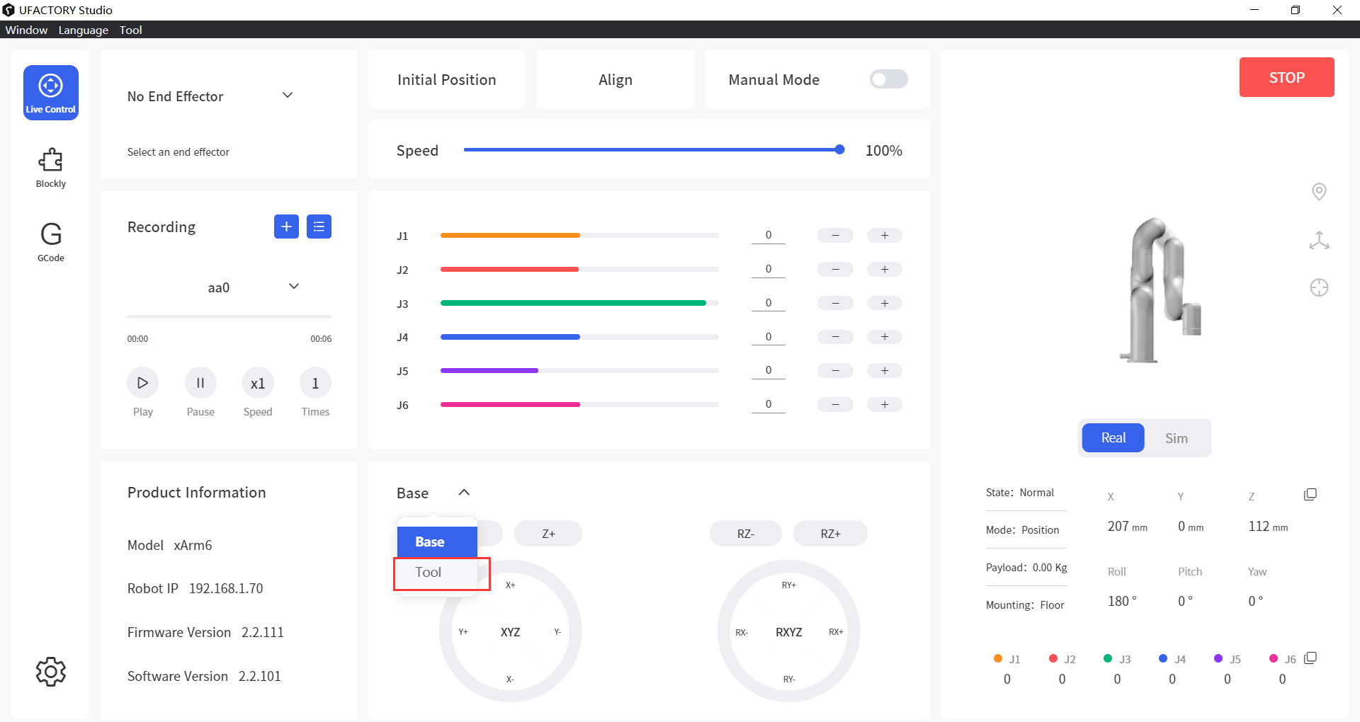

1. When the robot is at a pos of Pitch=±90°, adjusting the Roll of the robot will get the same result as adjusting the Yaw. You can bypass this issue by switching to the 'Tool Coordinate' on UFACTORY Studio or using the 'set_tool_position' of the UFACTORY Python or C++ SDK.
