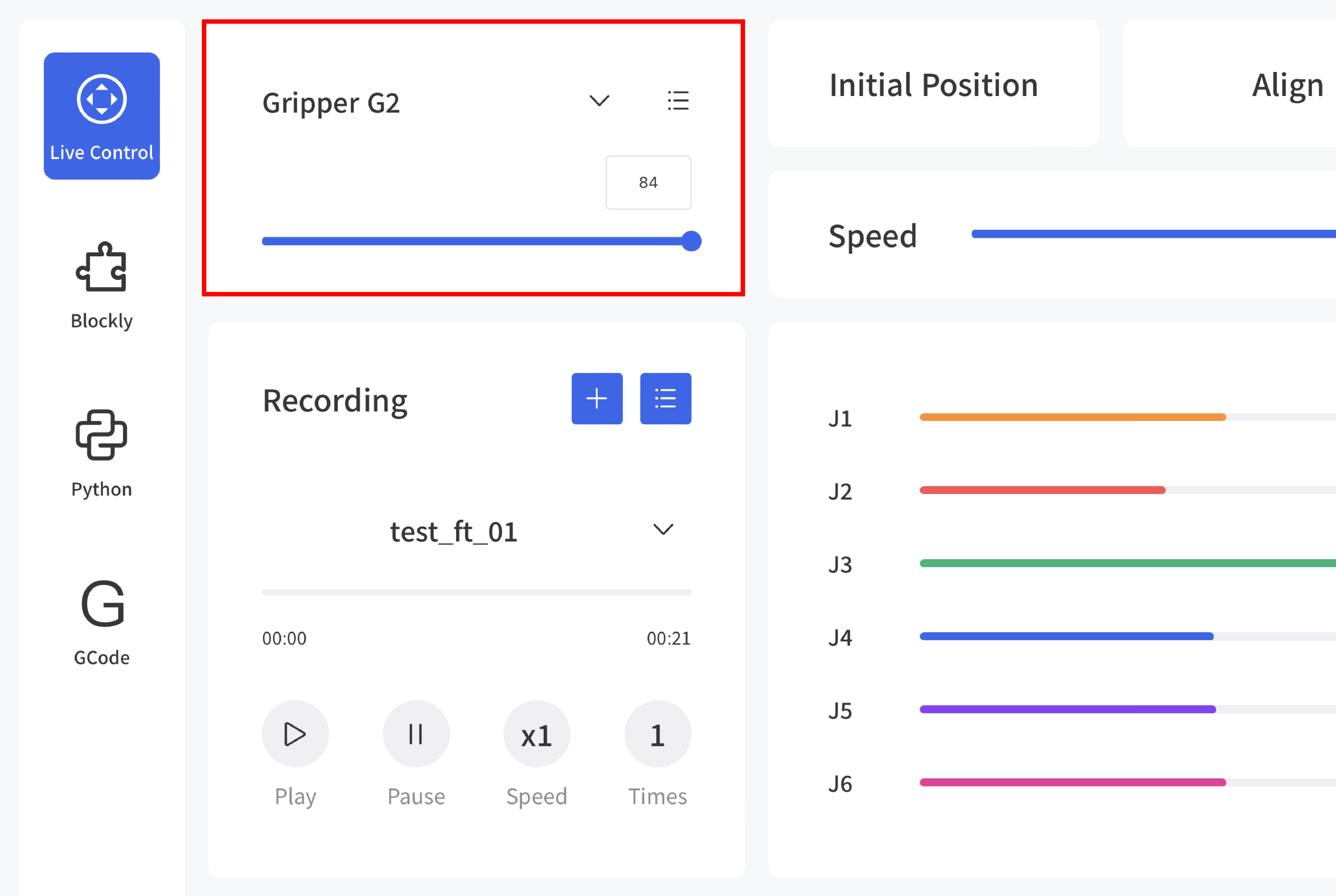

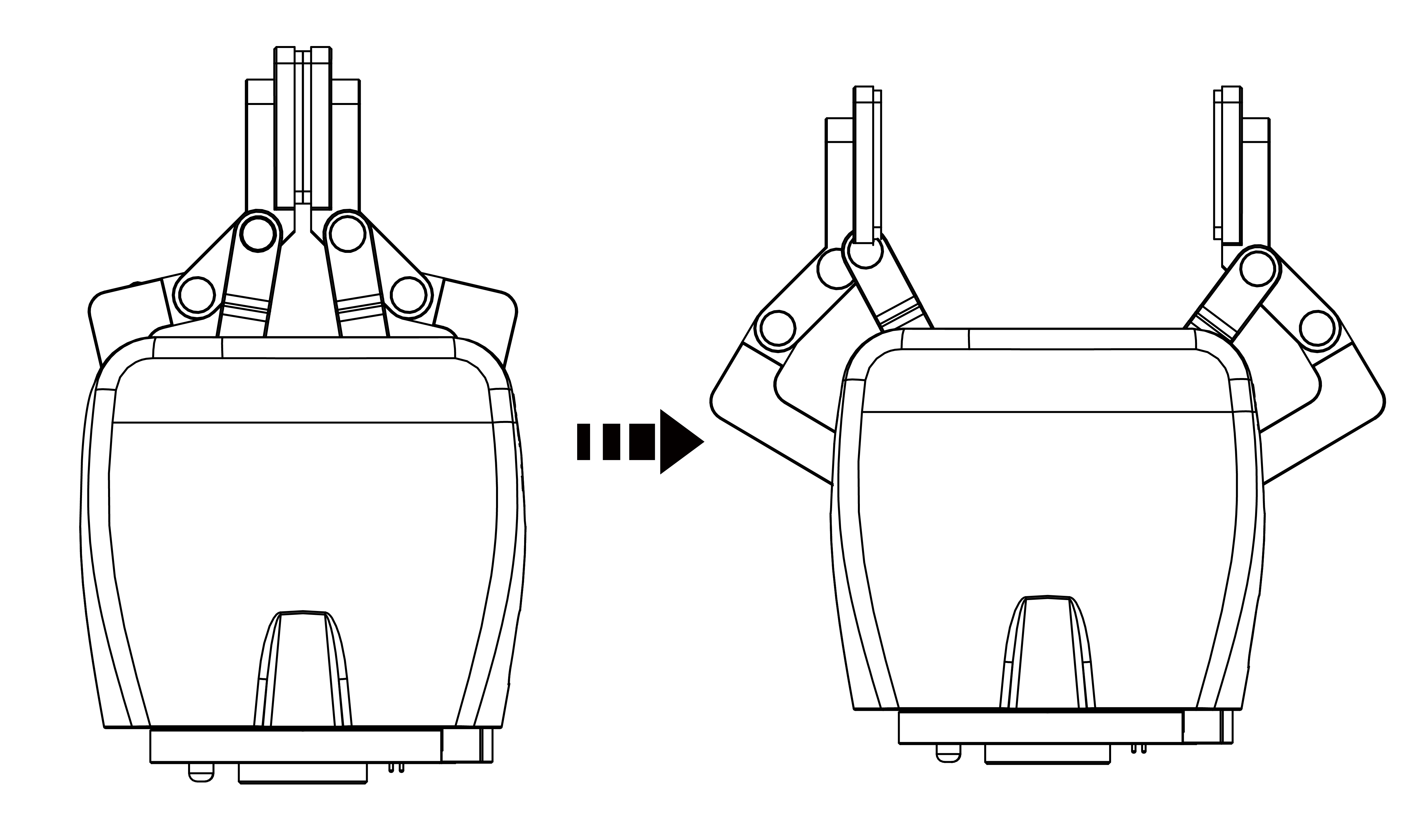

Step 1 ​
Open the gripper via UFACTORY Studio.

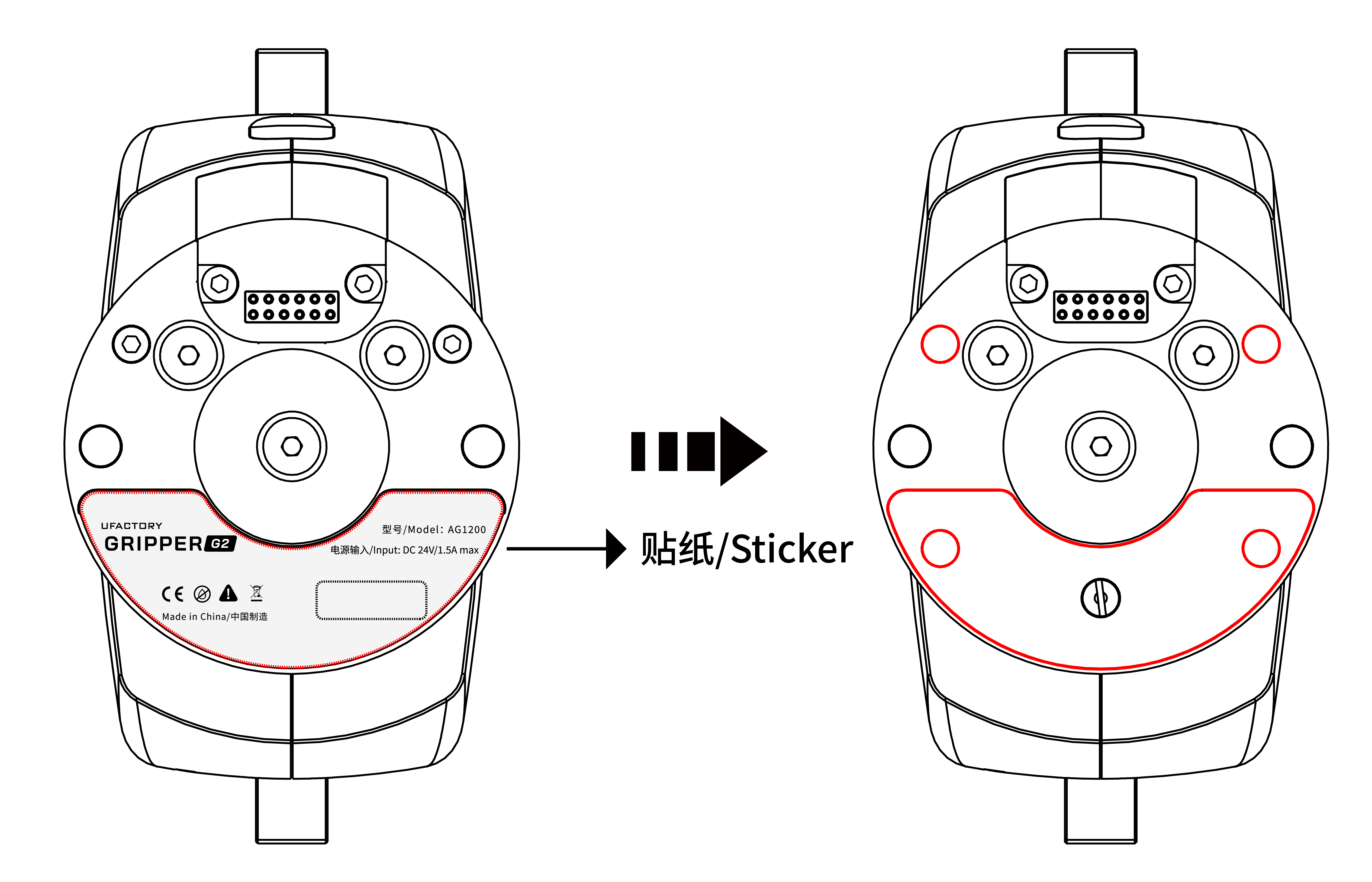

Step 2 ​
Remove the SN sticker, unscrew 4 screws. Please keep the SN, it is the only proof for any after-sales requests.

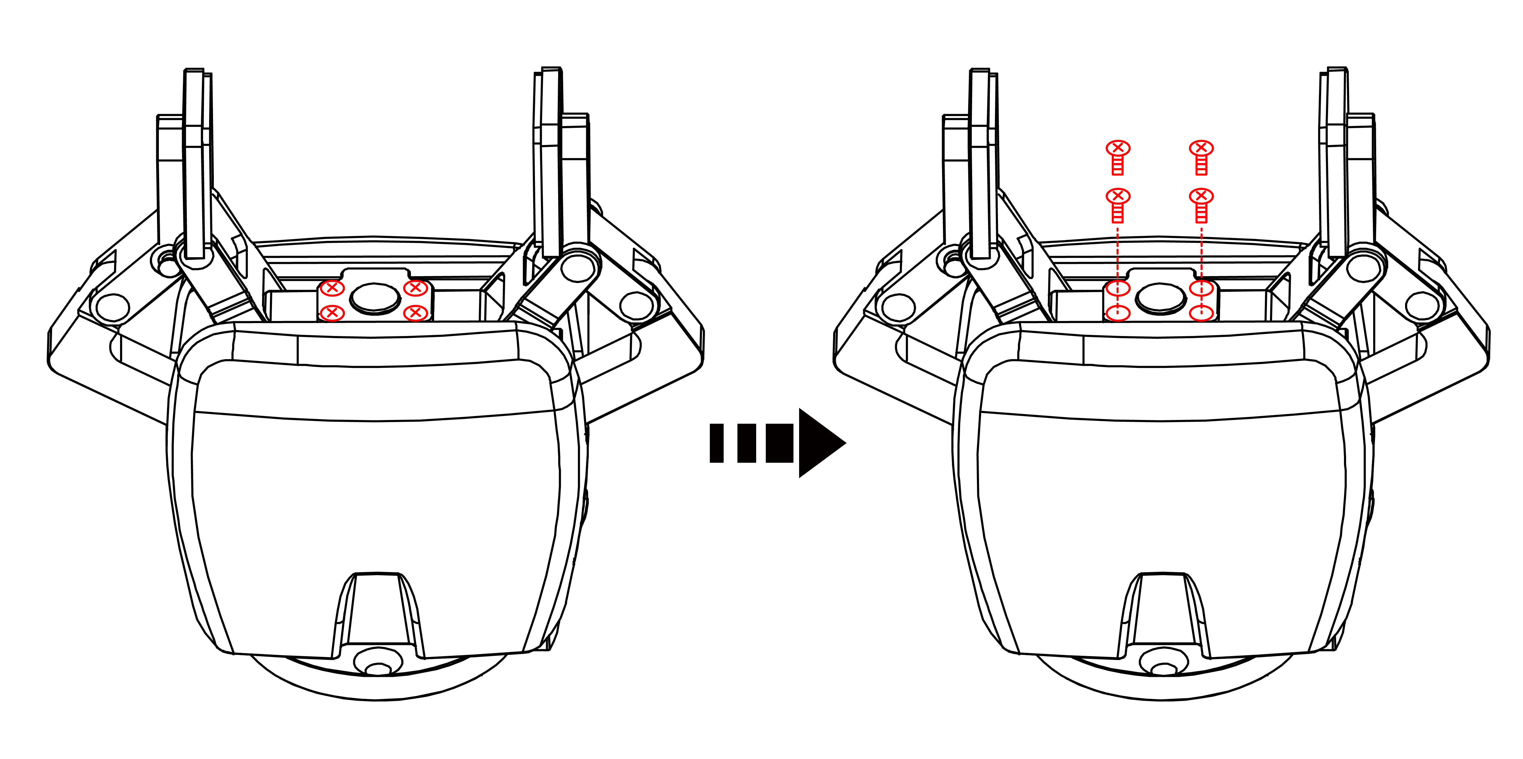

Unscrew 4 screws on the top.

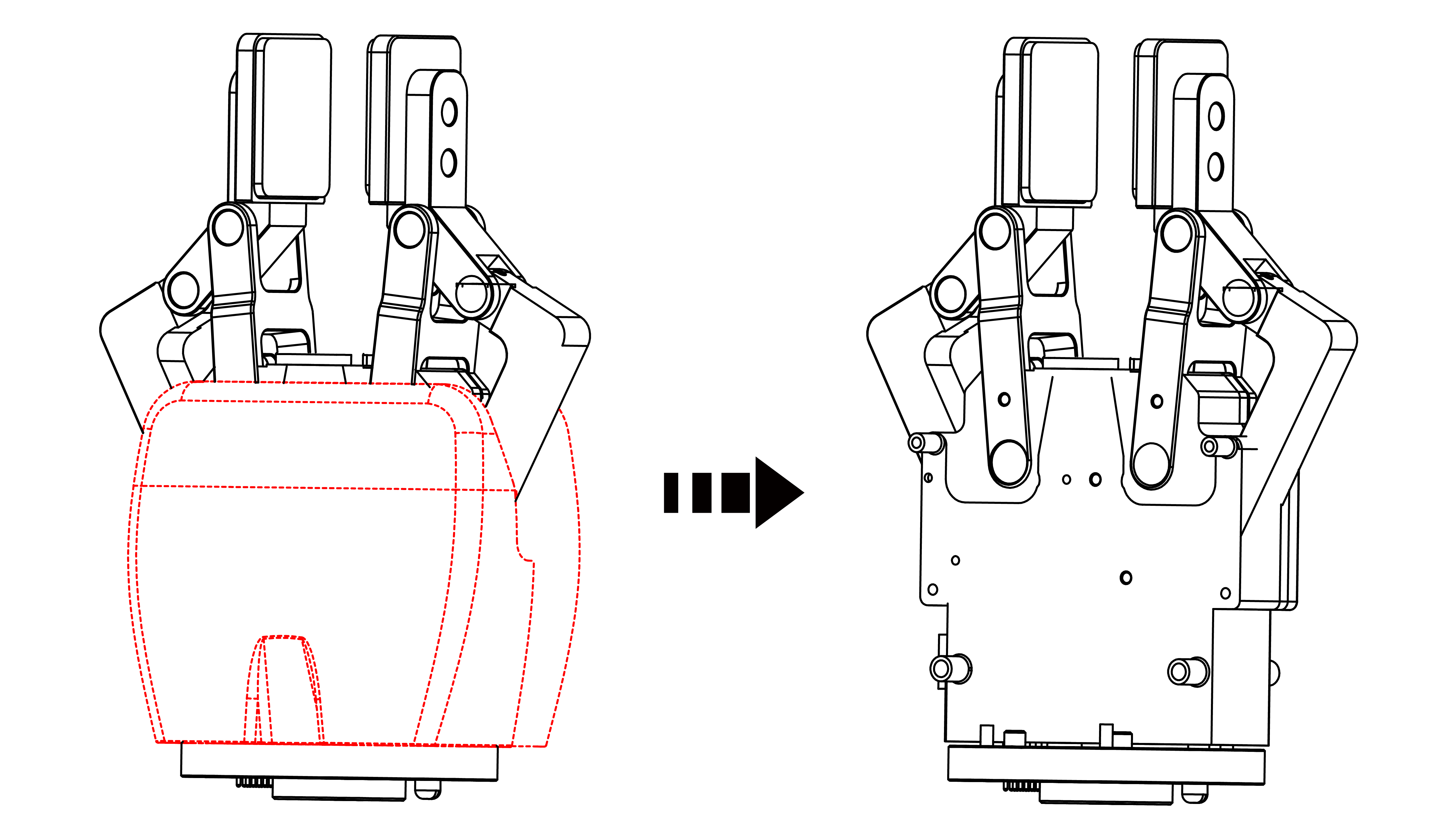

Step 4 ​
Remove the cover.
