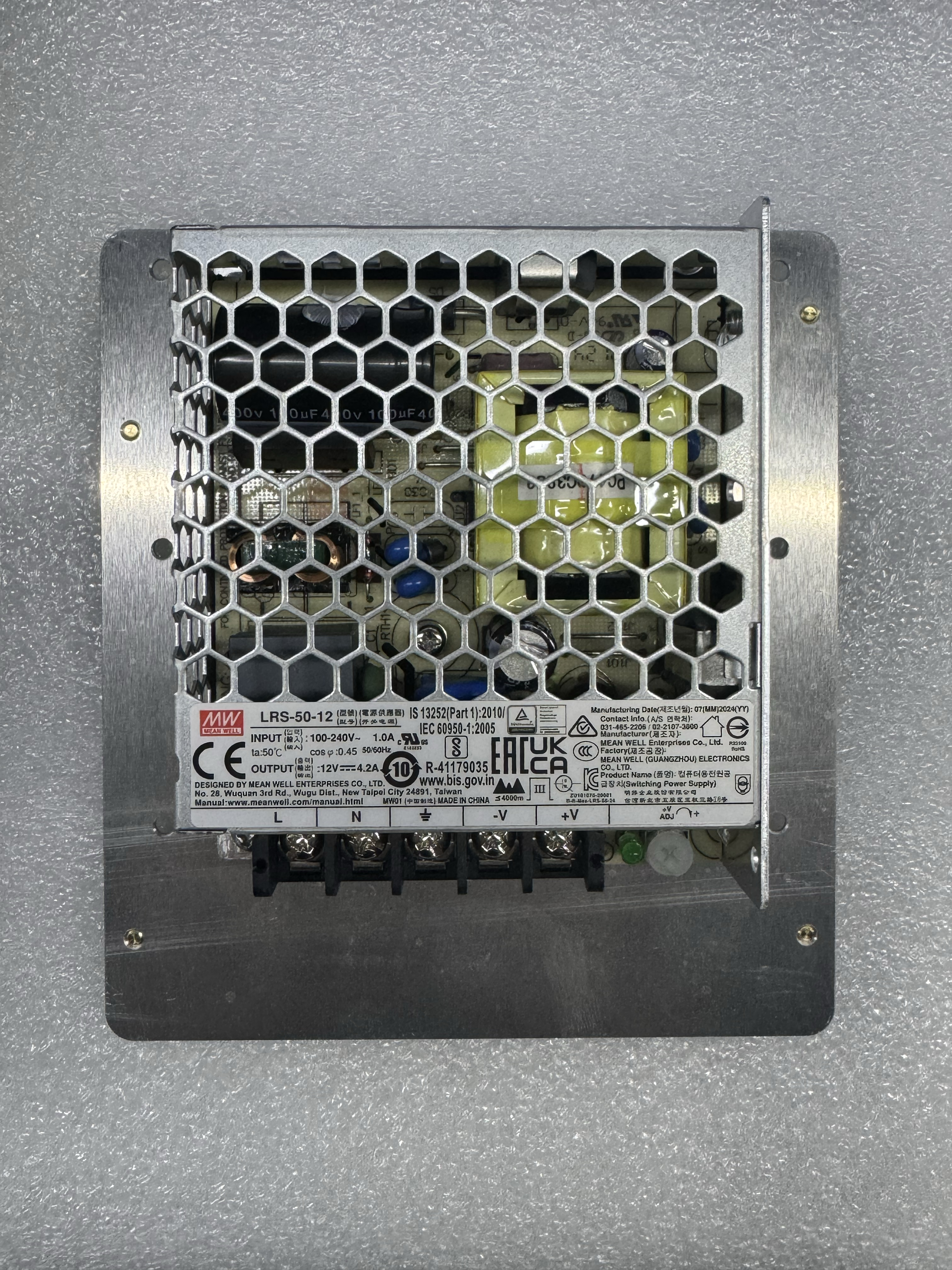

The model of 12v Power: MEAN WELL LRS-50-12

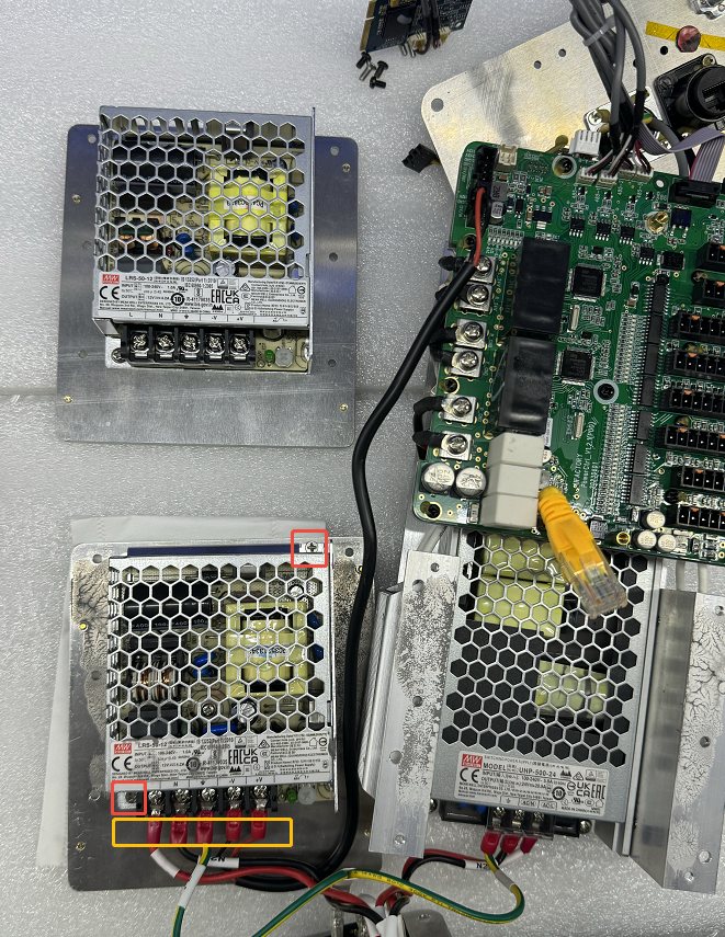

  2. Remove 1 screw and unplug RJ45 netport cable.

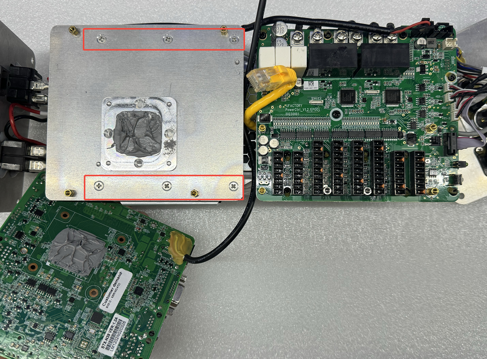

  3. Remove 4 screws.

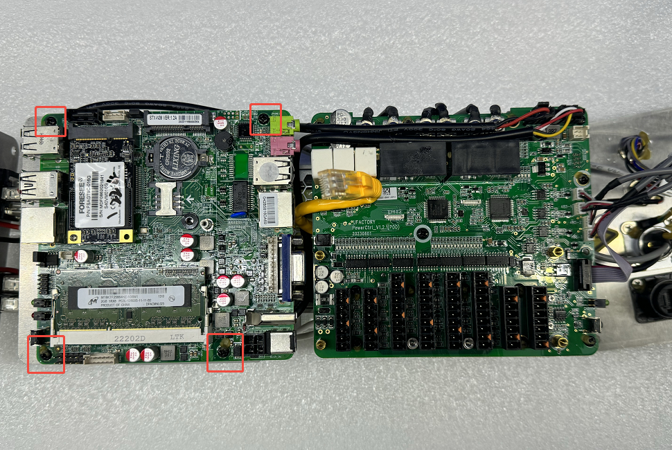

  4. Remove 6 screws.
  5. Remove 2 screws and 5 cables, replace a new 12V power.
