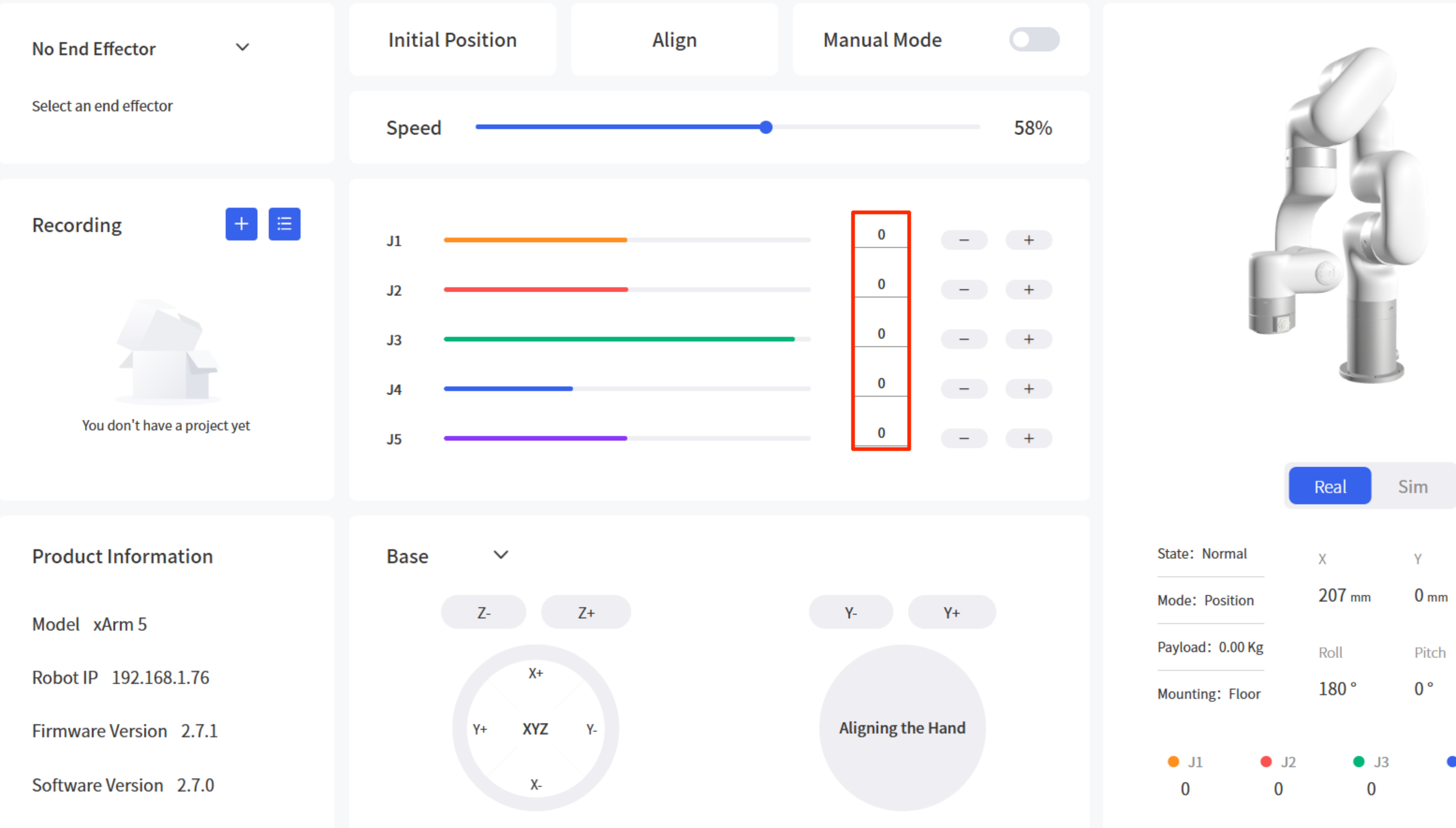

  1. Press the E-stop button.
  2. Keep only the 6 Axis Force Torque Sensor at the end of the robotic arm, and remove other end-effectors and cables.
  3. Release the E-stop button and enable, then control the robotic arm to return to the zero position (i.e., all joint angles are 0°).
    • Tip: Just check that the area around the arm is clear before moving it, just to safe side and avoid any accidental bumps!

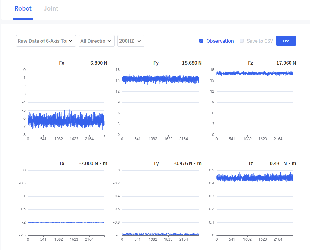

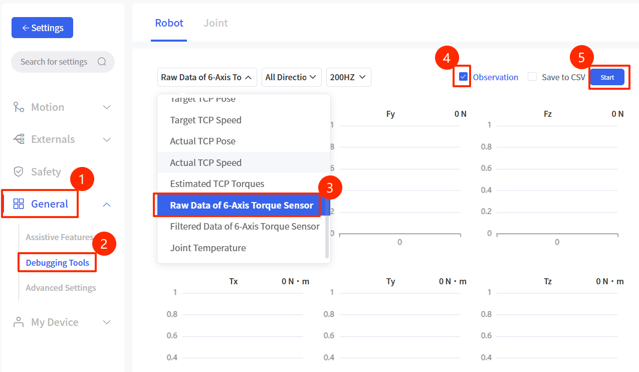

  1. In the “Debugging Tools” of UFACTORY Studio, observe the Raw Data of 6-Axis Torque Sensor.
  1. Compare the observed raw values with the static raw value range. If the raw values exceed the range, it indicates that the sensor is damaged.
    • Static Raw Value Range
Fx(N)Fy(N)Fz(N)Tx(N·m)Ty(N·m)Tz(N·m)
[-60, 60][-60, 60][-60, 60][-2, 2][-2, 2][-2, 2]
2. Solution ​
If the sensor raw values are confirmed to be out of range after the above troubleshooting, the force torque sensor is damaged. Please contact UFACTORY technical support for after-sales processing and provide the following information during feedback:
  1. Screenshot of the observed raw values
  2. 6 Axis Force Torque Sensor SN
  3. Photos/videos of the sensor's appearance
  4. Whether the sensor has experienced any collision, etc.
